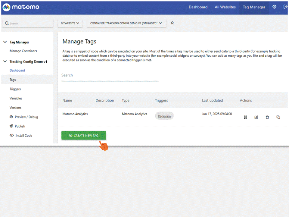

  3. In Matomo, navigate to Tag Manager > Tags and click Create New Tag.
  4. Choose the Custom HTML tag and provide a user-friendly name (optional).
  5. In the Custom HTML field, paste the initialisation script (copied in step 1).
  6. Set the Position to Head Start.
  7. In the section, Configure when the tag should do this, select a Pageview trigger.
  8. Click Create New Tag to save.
