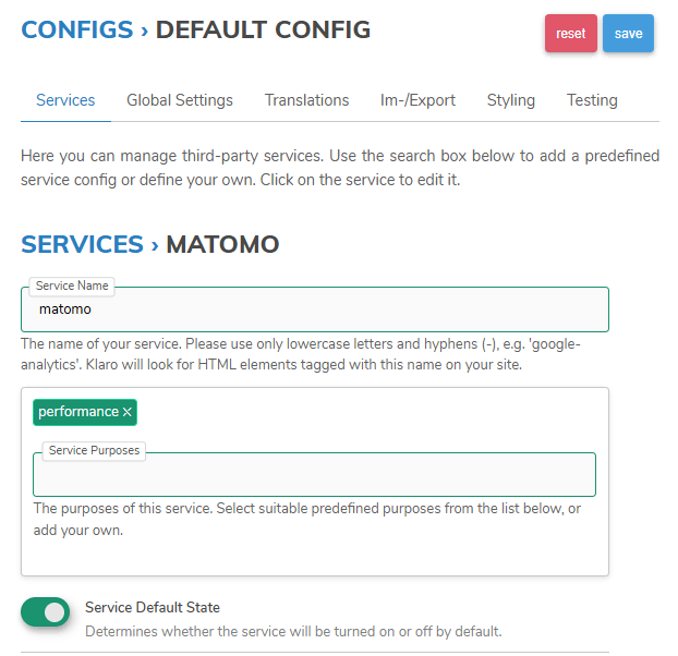

- In your Klaro dashboard, you will need to add the Matomo service. Go to the Configuration tab > Default Config (or choose a custom one if required).
- In the Add a service field, type Matomo and select it to add the service.
- Click on the Matomo service to configure the settings.
- Select Performance Optimization as the Service Purpose.
- Set Service Default State to On.
- Add three cookies with the definition entered as a regular expression:

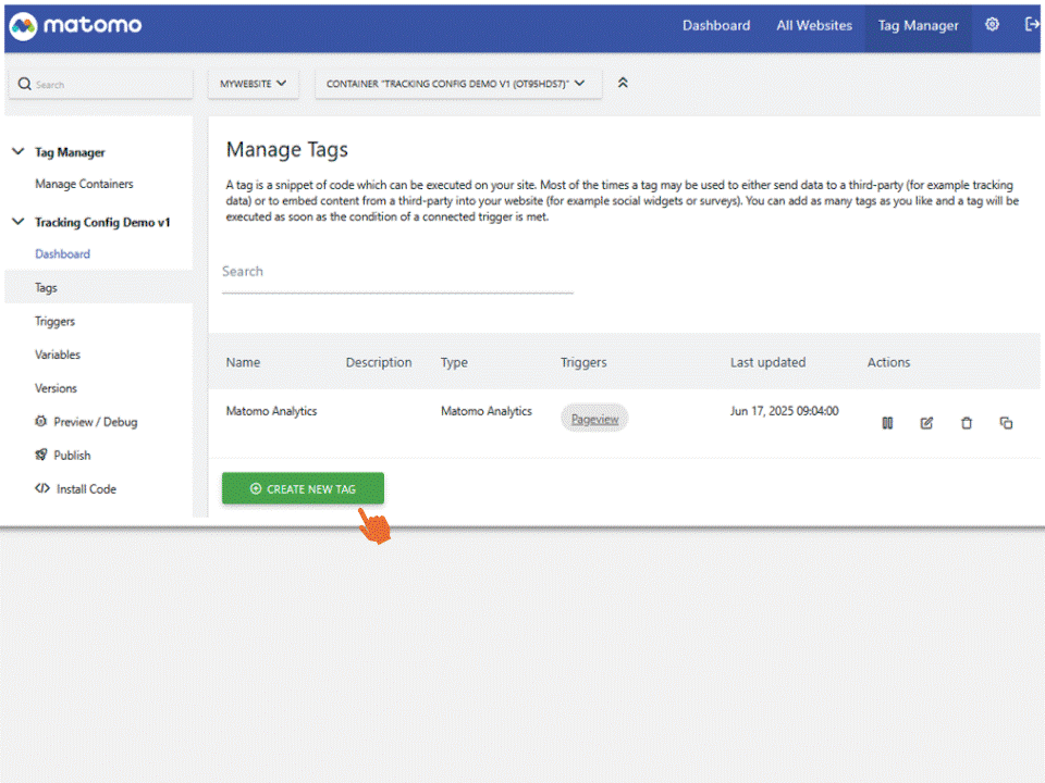

- In Tag Manager, navigate to Tags and click Create New Tag.
- Choose the Custom HTML tag and provide a custom name (optional).
