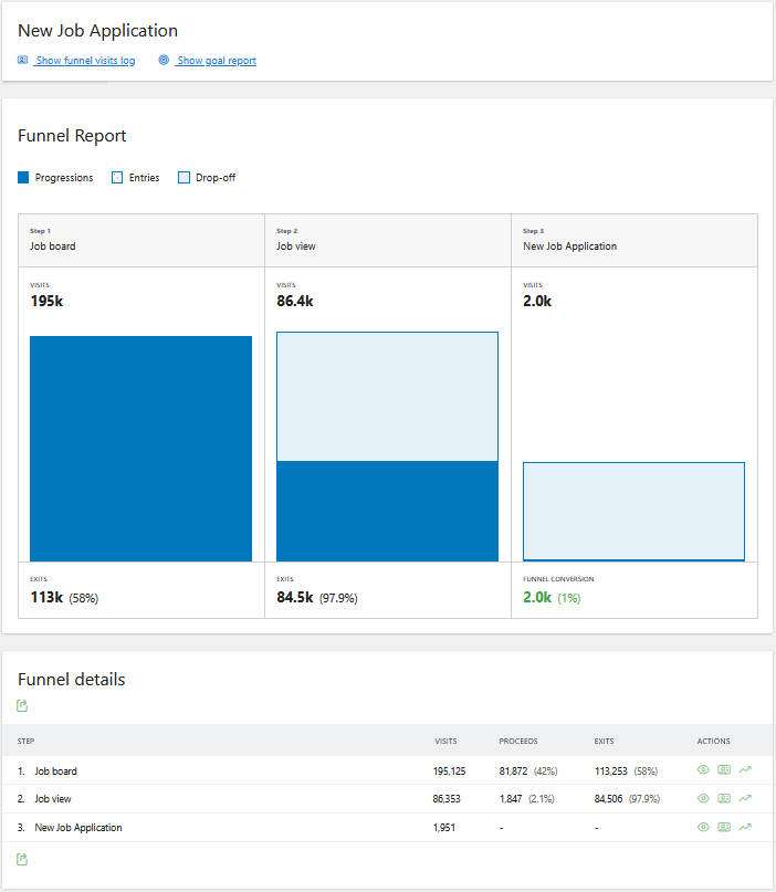

An example of this can be found on the Matomo Demo site where Job Applications are tracked:
  1. Job board – This is the beginning of the funnel where somebody views all available jobs.
  2. Job view – The next step of the funnel is viewing any specific jobs of interest.
  3. New Job Application – The final Goal of this funnel is reaching the job application form.
matomo funnel report
While your Goal metrics track how many people have applied for a job in total, you may also want to know what percentage of people reached each stage of your conversion funnel. Using the example above, you may see you are getting lots of visitors to the Job board and Job view stage, but for some reason they don’t click through to the application page. This would indicate there is potentially an issue with the job details or the final conversion step. For more information on this feature check out the Matomo Funnels user guide.
